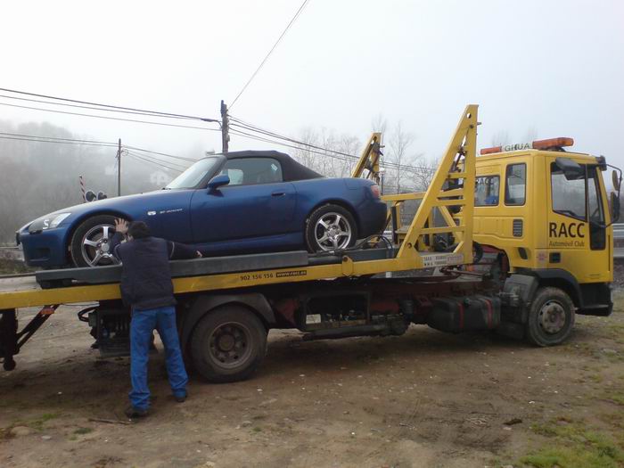

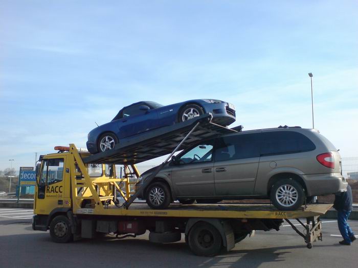

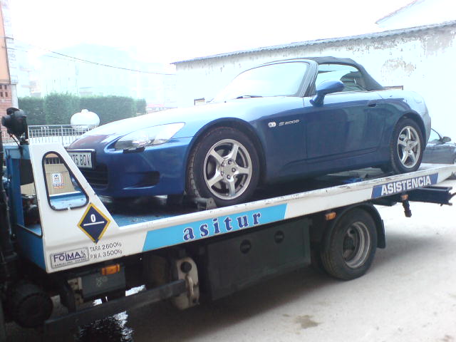

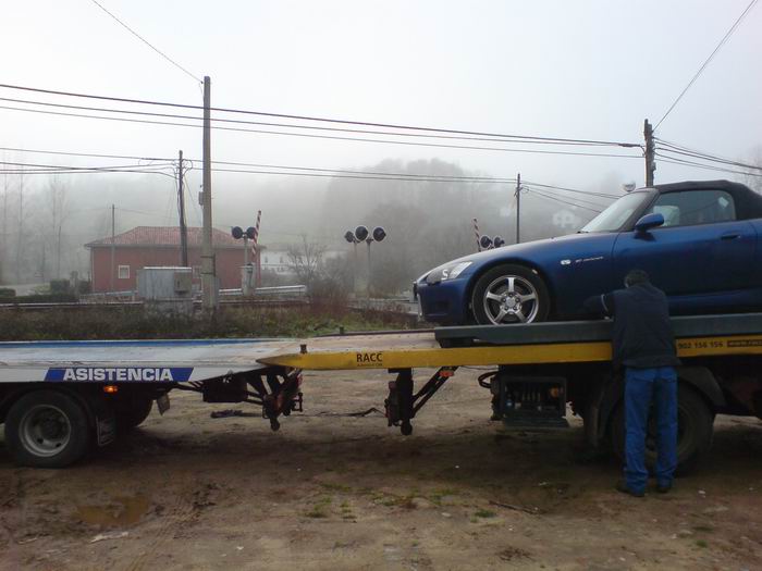

Well, thanks for the advices, specially to Slows2k, who induced me to tow the car instead of driving to there:
So, the dealer just open the top and found no valve adjustments issues, so they will go deeper...
Let's pray.
