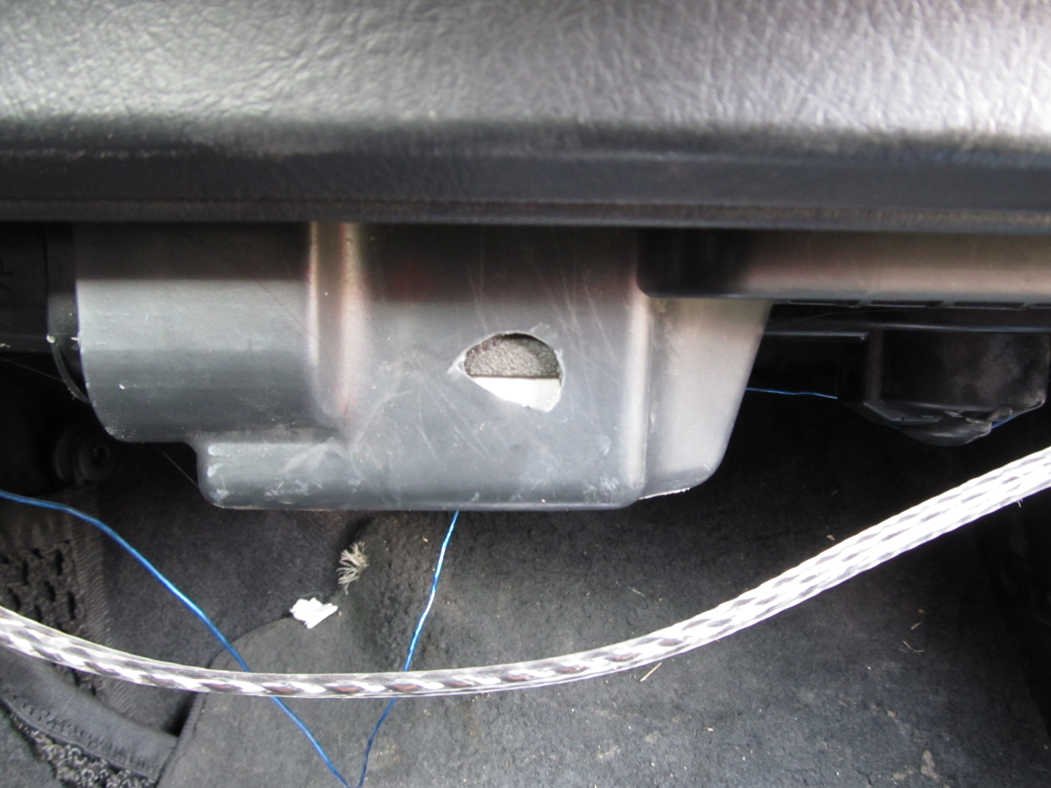

[attachment=63243:044.JPG][attachment=63244:045.JPG]Finacee has been complaining about cold air coming in thru this hole for awhile now. The other day there was a couple drips of water (real hot day AC on full blast) is this a real problem? How hard would it be to replace this part?

i wonder the same thing.
my wife was complaining to get cold drups of whater on her feet when the ac was full on during a hot day drive.

Blow out the a/c drain hose with compressed air. Looks like it's partially clogged.
